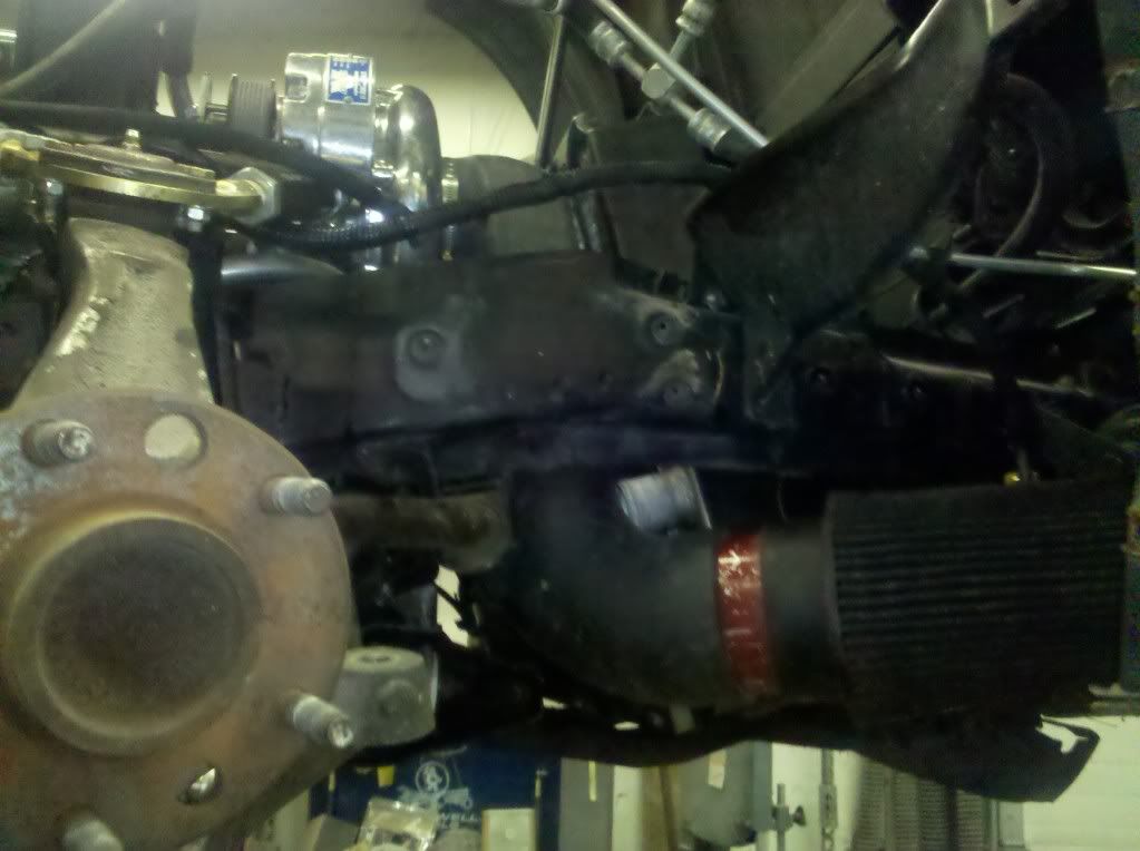

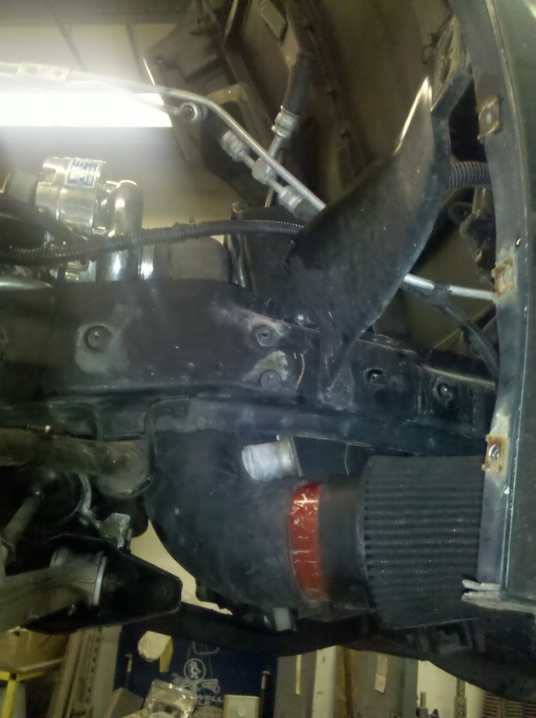

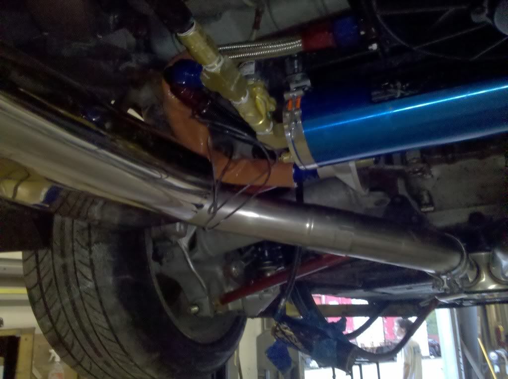

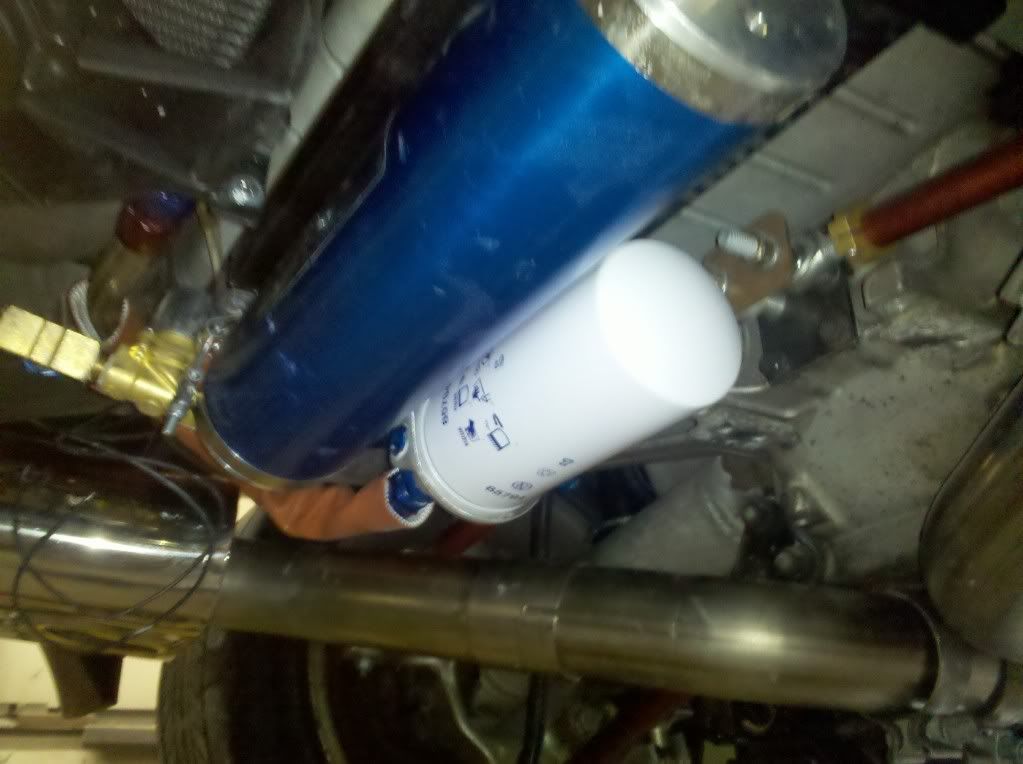

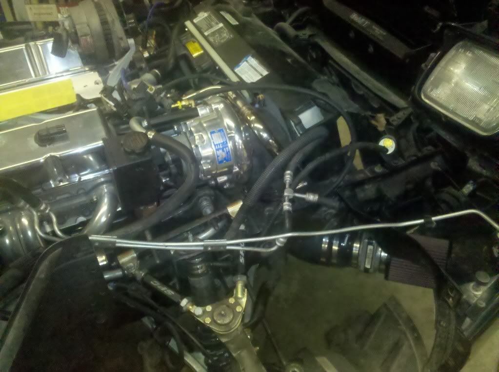

BrianCunningham [update] this should keep it cool
Senior Guru
Boston, MA for the most part :)
7763 Posts
2007/12/30 0:00
oil cooler accusump & filter where the spare used to be
Photobucket
installed w fan and LARGE filter
radiator needed to come back out.
4in intake blocked one of the radiator opennings
new neck welded on an reinstalled
Exotic Muscle long tube headers fit no problem

Nice...so are you close to driving it?
What's the plan for getting air across the oil cooler, some fans?
Posted on: 2011/5/31 13:04
aka Scaryfast
BrianCunningham Re: [update] this should keep it cool
Senior Guru
7763 Posts
2007/12/30 0:00
Just some minor things left, lengthening wires etc
There's a 1300cfm fan on it
I'll take a better pic later

Brian -- Very impressive! I thought about an oil cooler too, but I just don't know if I really plan on tracking this car or not. I know I will do some Autocross with my club, probably 6-10 events per season. But I sure like the set-up you have. Nice big cooler too! Are you putting a fan on the cooler?

Looks impressive! Are you concerned about possible damage to the cooler due to road debris?

Not really I've seen them mounted there on racecars

BrianCunningham wrote:
Not bad, I'm reserving that area, and it's twin, in case I need and intercooler in the future.
Update - had trouble keeping the oil cool in this location. I think it would be fine for the intercooler, but the extra power seems to need more flow. I put the cooler back in front of the radiator. I may buy a fancy expensive cooler and try here again, but it's working now so who knows...
Such a nice bracket going to waste.

The Corvette Racing C5R and C6.r use the rear license plate area for a cooler - but that's for the trans and diff assembly.
First thought, that's a lot of line to run for the oil... and 2nd, if you flush mount it, how will it get airflow?

Airflow restricted, only way to package it w/o cutting a hole in the bumper, but I got a large fan on it.
Heat is what kills FI engines, so getting all that heat out of the engine compartment seemed to be the way to go.
