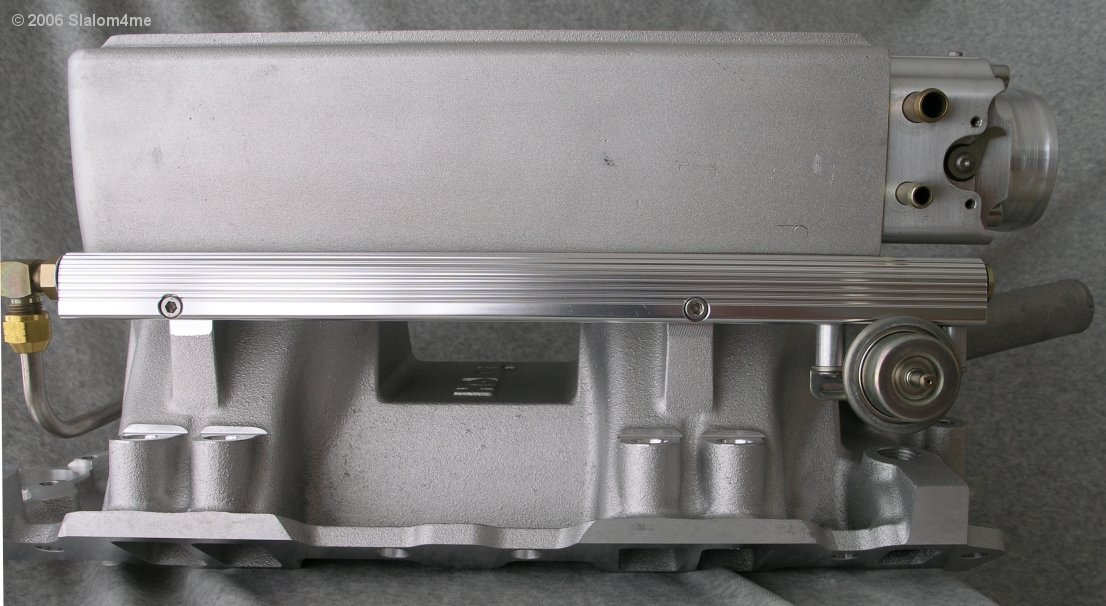

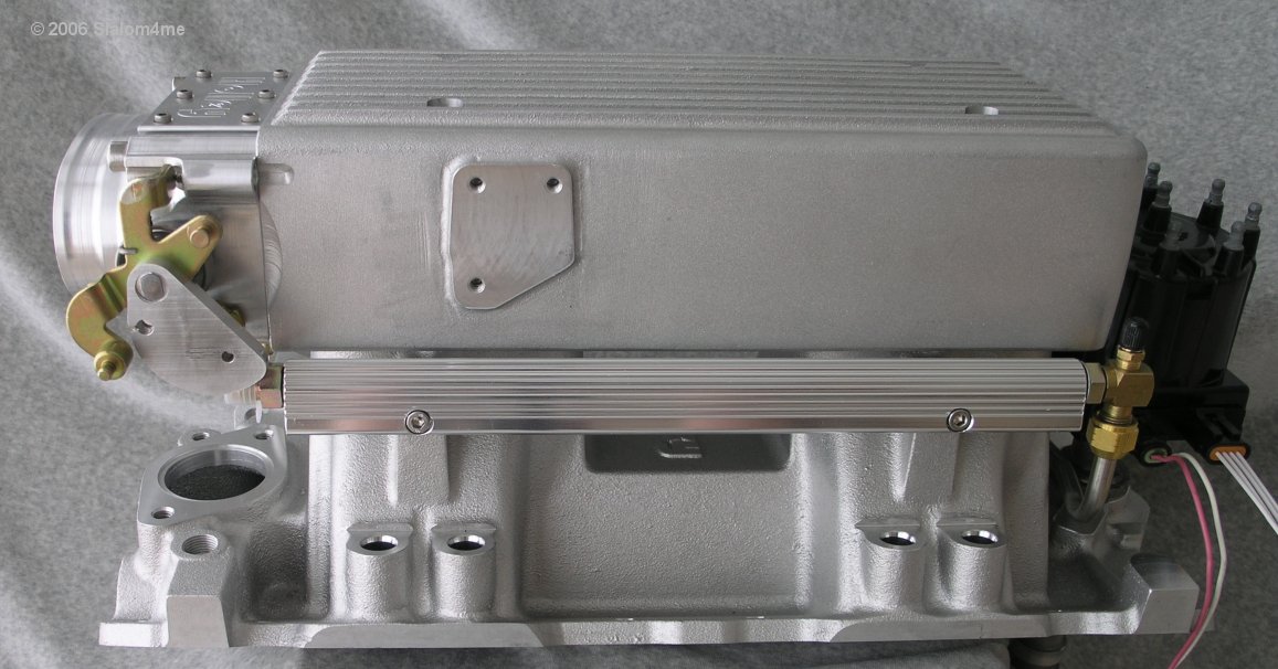

Are we thinking along these lines???

Blank Canvas
- A Side
- B Side
Either reposition the existing OEM/Aftermarket throttle
body, or introduce an additional degree of difficulty ...
Four of these:
Plus a pair of these: one for each cluster of runners
Finish with four of these:
Posted on: 2008/10/4 5:06

- No plenum redesign or fabrication required
- No bell-crank mechanism required for throttle actuation
- No special provision required for TV cable actuation
- No need to redesign Air filter/MAF/Bellows componetry
- No need to adapt IAC operation for aftermarket throttle bodies
- No need to adapt IAC/MAF/TPS harnesses
- Esthetically more pleasing appearance
Oh, and it is generally cheaper to mount the TB there
in front than anywhere else.
Posted on: 2008/10/4 14:35

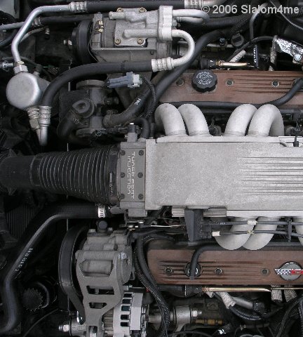

The accessories at the front of a stock L98 engine present
some obstacles for unconventional routing of inlet air to
the throttle body.
Also, although not shown above, the master cylinder is
adjacent to the #1 & #3 runners.
Nothing impossible to overcome, just more head-scratchers
to solve along the way to completing such an undertaking ...
Posted on: 2008/10/4 16:03
