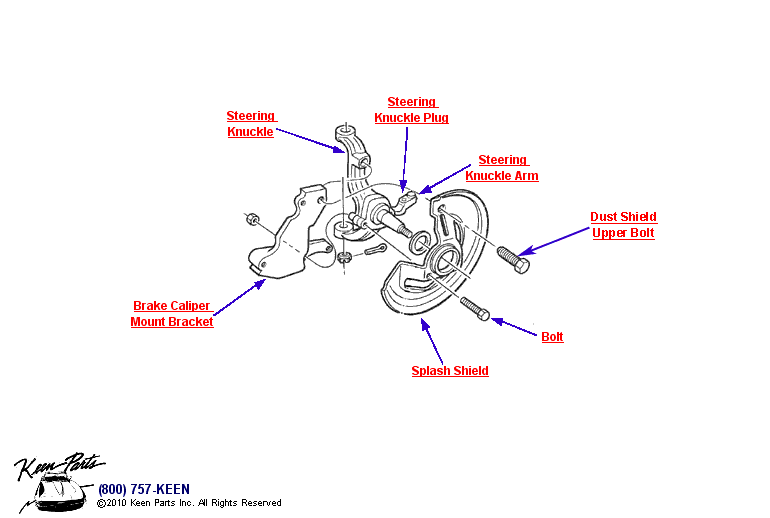

I believe DB is referring to the outboard tie rod connections - there may be two holes in the steering knuckle arm. Of course, the inner hole would give you quicker steering response.
I don't really know what would make it feel "touchy". Has it been aligned lately?
