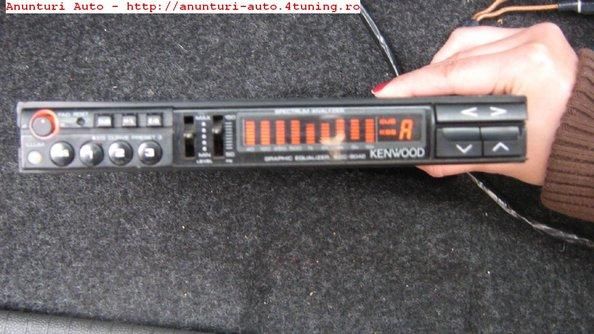

Another option is the level control but then also have an EQ (then it would not NEED to have the Volume on the EQ and the EQ could be hidden, so if I go THAT route, I have an older Kenwood EQ I can use.. KGC-9042:
Not my Pic
THAT I could put in the glove box and then have the remote volume control on the bezel..
THAT would work, I just cannot see using the Clarion and having 2 volume controls

That is cool, but it still poses the issue of where to install it...
I was thinking of putting the EQ in the area below the tablet (the dead space of the bezel.
the problem is there is no room behind it due to the dash structure and ABS Accelerometer. I am not going to cut the structure to fit it.. The KGC-9042 I have works I can use that with the Level control and Get some frequency adjustments, I also can use it as a balance control...
The Clarion is nice as well, if it would fit.
I can stick the kenwood in the glovebox (I think) then not worry about it once it is set as I will have a remote level control for volume.
The Cassette deck I have does not have SCV, just the CD/Cassette, which I have one I don't want to tear apart, but it would be nice to see if I could get that to work.. there are 2 cables going from the Cassette Deck to the control board in the radio.. one set is 3 wires that is Audio, the other set is unknown.. mostly whitish wires and one red, I am guessing the red is power and the others are control wires maybe. I wish I knew which is which as I am guessing one of those control the main unit to know when the cassette is selected.
going with OEM and SCV I lose the balance and I don't need a fader, I need balance left to right
If I use the Line driver, I get no balance or audio controls ( treble mid bass) but I get the most power out. I can find a Stereo 10K Taper pot, but not a Stereo 25K linear yet, if I find that I can build a balance/level controller

Maybe.. need to look
I thought of that too, just have not looked..
the Clarion is 4" deep, the Kenwood is 5-1/2"
I think the Clarion would fit in the glove box..
Wish thy made an EQ with a remote face.. or such
