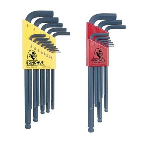

I've had a hell of a time with the headers tonight. Not really in a cheery mood. A little gentle persuasion with a BFH was necessary along with slightly enlarging the two outer bolt holes. Still not done with one side! I need a set of these for the allen cap bolts:
The ball end makes it easier to swivel and tighten. Might get a set tomorrow.

McMasterCarr has them in singles.
Also straight ended ones so you can use it with a socket.
One day delivery to you.

Thanks Joe, but a whole set is like $12. I actually have a socket style allen/hex head in the right size, but it only works on 1/2 the bolts due to header clearance.

Get the Bondhus in the pic. NOT the ones at HF.
And, if possible, do the final tightening without using the ball end.
